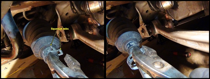

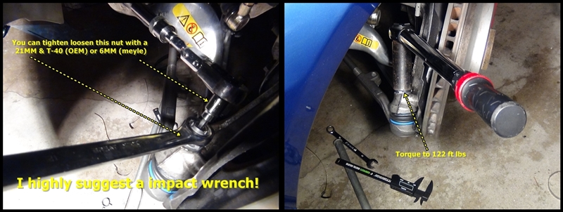

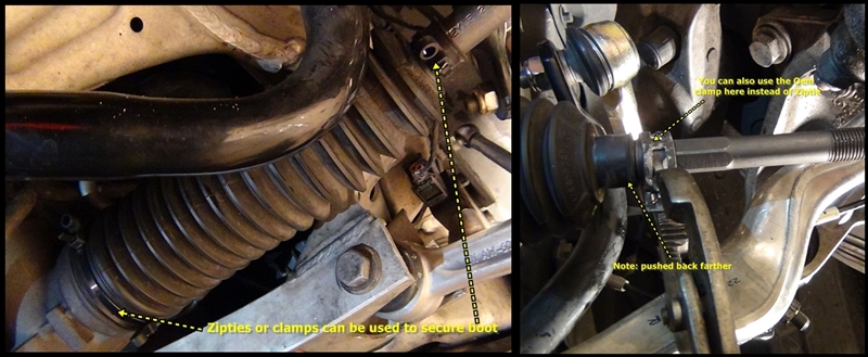

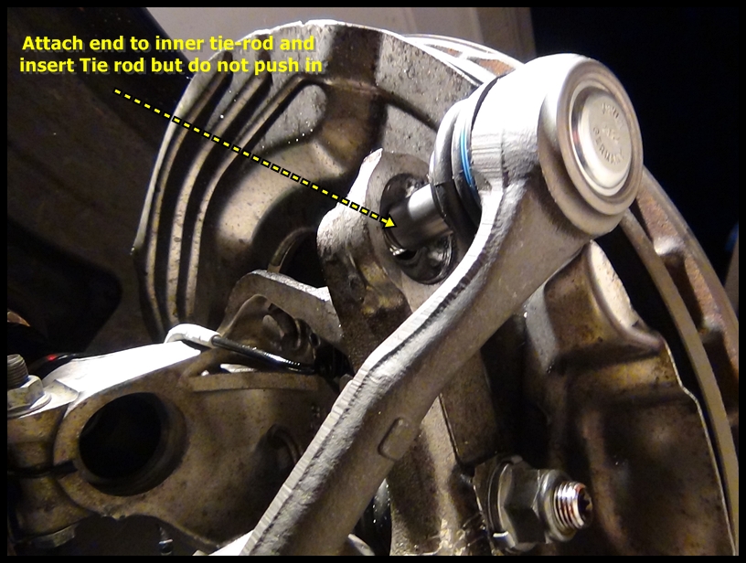

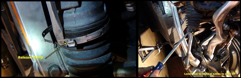

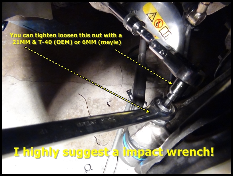

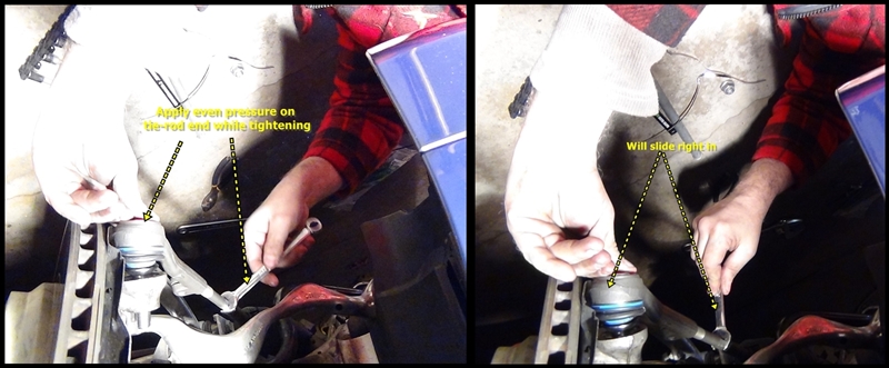

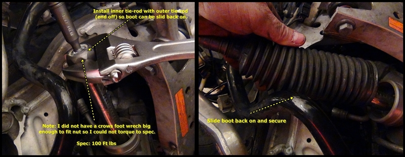

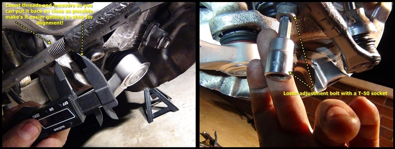

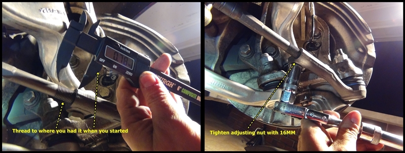

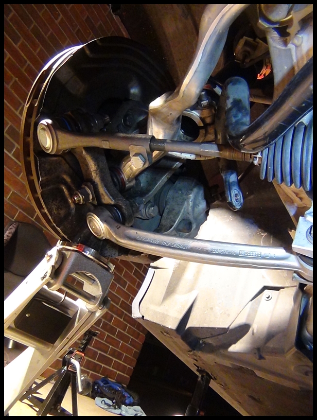

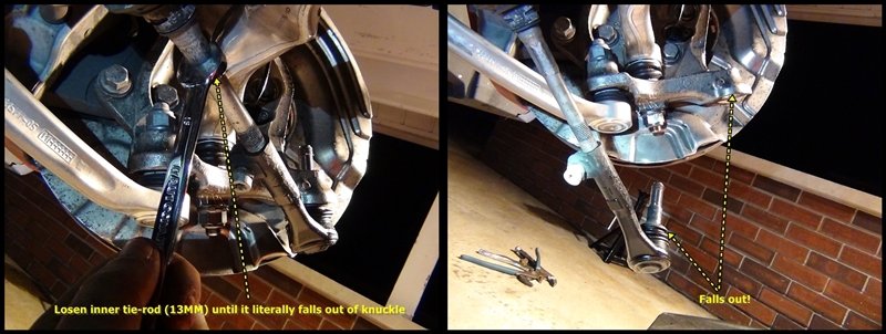

    Meyle HD/OEM Inner Outer Tie-Rod DIY
    Meyle Hd Tie-Rods can be ordered here:
    http://hpashop.com/BMW-E8X-E9X-Z4-HD...Rod-E8x-9x.htm
    Note: Not responsible for any damage to you or your car, this worked on my car so will work on yours.
    ***This tutorial assumes you know how to get your car secured on jack stands, if in doubt do NOT attempt this DIY!
    Tools Need not in pic (2 jacks if possible, (1) for a safety catch in case jack stand fail (I saw this happen and will NEVER forget it)....safety 1st).
    Torque specs:
    Tie-rod to knuckle 122 ftlb (165 Nm)
    Inner Tie-rod to steering rack 100 ftlb (135.6 Nm)
    Suggestions:
    Alignment is 100% neccessary, no ifs about it! your car will ride like a POS afterwards.
    I suggest coating all bolts with bolt penatrating formula, applying anti-seize to all bolts

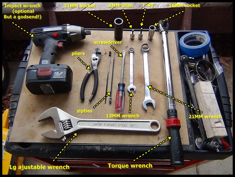

    Tools needed:
    Step 1:
    Step 2 :
    Step 3 :
    Step 4 :
    Step 5 :
    Step 6 :

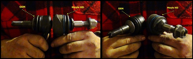

    Comparison of OEM Vs Meyle:
    Step 7 :
    Step 8 :
    Step 9 :
    Step 10 :
    Step 11 :
    Step 12 :
    Installed!!
    Impressions:
    Noticed a improvment right off the bat, steering is much more crisp, no more vibrations and you feel a lot more in control...for $154.00 this is a no brainer.
    Alignment specs

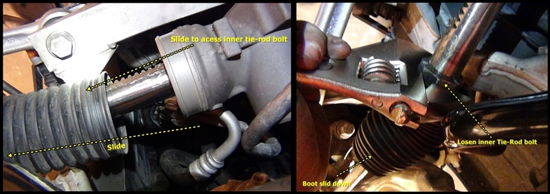

    You're suppose to keep the steering rack turned to the opposite side your working on to prevent damage to the rack.
    Great DIY guide though!

    Click here to enlarge Originally Posted by e90n52b30 Click here to enlarge
    Yep, it was LOL! Really cant tighten the bolt on tie rod if it isnt.

    Click here to enlarge Originally Posted by robc1976 Click here to enlarge
    Ahh ok. It looked like in step 6, the rack was turned out. Just wanted to mention for others.

    Shiiiiiiiiiiit. Just replaced mine a couple months ago and didn't even really think to get anything other than oem again. These look beefier than stock, so pissed. Good write up tho!!

    Click here to enlarge Originally Posted by CubanJJ09 Click here to enlarge
    They are beefier for sure!
    Love your guides btw. I'll be tackling the subframe bushings and replacing them with M bushings soon
    You are right, it is not mentioned and needs to be because the pics do not show this enough...I will add that in! The M3 bushings will be much harder to press in....just letting you know, but I am sure are awesome though!
    Is that means to turn steering wheel in opposite side of the one you working on? Thanks

    Click here to enlarge Originally Posted by joro2077 Click here to enlarge
    Yea you turn the wheel away from the side you're working on.
