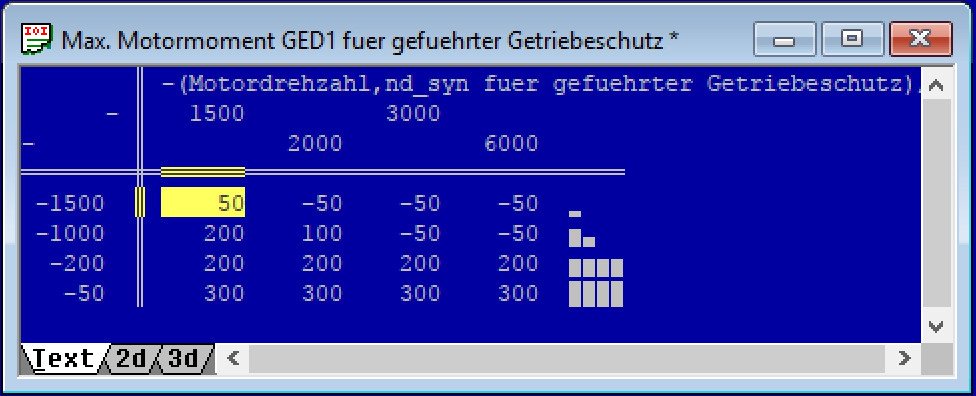

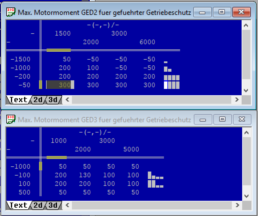

Next, I tracked down a comparatively low cost source compared to what people were asking at more mainstream sources, but still pricey for individual enthusiasts to take the risk buying, for two WinOLS OLS files for suspected similar TCUs (VAG 6HP28 and BMW 8HP45) as there is no publicly available OLS for our TCU ROM. These are effectively leaked full map information for the TCUs that they apply to. @TwistedTuning generously stepped in and purchased both of these OLS files. This paid off well because it turns out that the VAG 6HP table layout is very, very similar to ours for the most part. I was able to track down a handful more tables that I think will be useful for tuning, based on just an exported map list from the OLS file as these files were not able to be opened with the latest WinOLS demo. If you end up doing custom TCU tunes or receive a custom TCU tune, please consider swinging a small PayPal donation through to Justin at @TwistedTuning . We would not have these files without him.
The big hurdle/wall that we had ran into was that we can only do so much with an exported map list. There are sometimes 20 or more maps with the exact same name! What on earth does each one do? I was preparing for the worst (flashing and testing every single one to see which gear change it applies to, rinse and repeat). This is where @Sticky at BimmerBoost.com has stepped in and put his hand up to make the substantial purchase and provide a WinOLS license for 6HP XDF development. I have just finished getting this set up and I've just gone from insufficient information to information overload! All of those identically named maps now are in separately labelled folders! We now have the axis information and much more. I haven't even delved in to some of the advantages the full version has over the Demo yet either! This has opened the floodgates for moving forward with the 6HP TCU XDF development. Support those that support us! BimmerBoost.com certainly has a great user base and it's always been my preferred forum for technical discussion.
